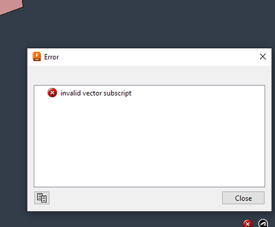

RC-CnC
in reply to: HughesTooling
 Interesting this is what I end up with
HughesTooling
in reply to: RC-CnC
If I change the compute type to optimise it seems to work.
Another odd thing is if I change it to identical, mirror fails completely. I wonder if some of the problem is because the mirrored holes end up concentric in your example. @Phil.E Can you take a look?

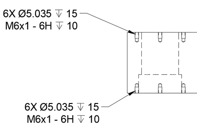

When the holes are mirrored, the drawing shows some interesting results.
  • On the mirror-result side, 10 holes are created
  • The drawing shows the threads on all of them
Question: is it intended to have left-handed threads as a result of this operation?
Personally, I would never mirror anything unless I need a mirror. Mostly because the part would then be modeled wrong, assuming I don't really want left handed threads (w/hundreds of designs in production, not one with LH threads, so I'm a bit biased). This would show up in a drawing, and if not detected/corrected would result in something like the purchasing manager referencing that drawing and buying a bunch of custom LH screws, and some confused assembly staff.
Looking for a workaround that doesn't result in  LH threads, I projected the first hole-point onto the opposite face, created the same hole twice. The hole command was kind enough to remember the settings of the first hole, so I didn't have to do much to get a second hole exactly like the first.
Then do the circular pattern, include each of the holes from either side of the part.
Ended up with all RH holes, only 6 show up in the drawing, and the same number of timeline items created. IMO, projecting the holes to the opposite face is easier than adding a plane/mirror combo. Mainly because it creates no additional geometry, eg. the construction plane.
