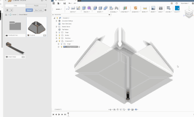

Yes there is! The problem is that Cura install a new version and so you'll need to select 'Custom' then the folder and navigate to the new Cura .exe application file.
