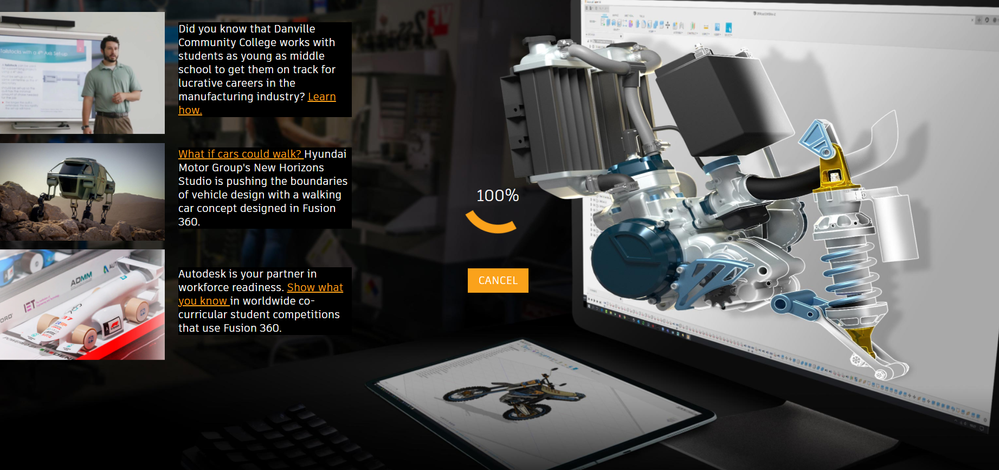

I am trying to access the browser based online fusion 360. When I load it up, it will spin at 100 % and not fully load. I do not know why it is doing this, perhaps it is because I am using a public school wifi, but I do not know why it will not load fully.2021-10-26 (2).png

Thanks for posting this. I'd like to help but I need to ask some questions to clarify.
How long has this been happening?
How many times have you gotten to 100% but no farther?
Can you try restarting the computer and try again?

Good Afternoon,
I administer a few labs for a school district that use this software, and the same issue popped up on our Windows lab computers.
The students use Chrome on the machines, and I resolved the issue be ensuring that Chrome was set as the default browser for the student.  This resolved the issue in all cases I ran into.
