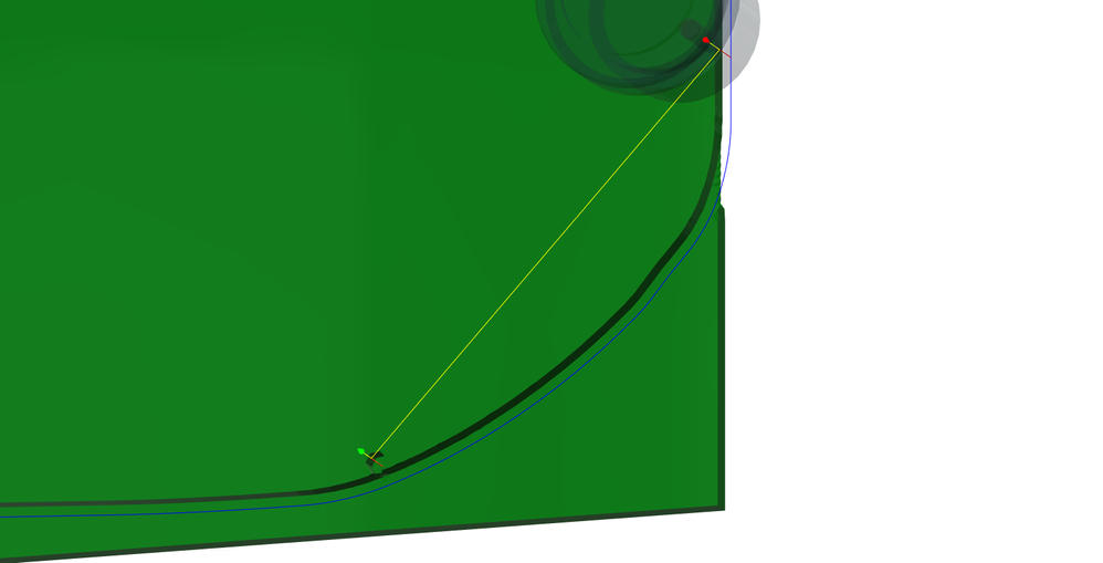

hi community,
Lately I've been getting some unexpected holes while using the 2d contour program to cut out some shapes. Seems to always be with a climb cut. They're happening either at the start of the program, or as shown below at the end of the program and always on the other side of the contour that's being cut. It just pecks a hole down and comes back out. There's nothing in the file sketches (or models) at these points and the path is following 1 continuous chain. As below that chain starts/ends where the tool is seen.
Changing the contour program (multiple depths, etc) doesn't always lead to a solution. For example, in the file below conventional milling cuts as expected but climb milling creates an extra hole. And sometimes if I switch to conventional milling, then back to climb cutting the hole disappears.
Am I missing something or a is this a bug?

jhackney1972
Please attach one of the files showing this issue.
