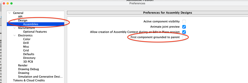

and, while you are at it, turn off the preference that created this in the first place:

ajarizaleta
Thanks Jeff, that made it
