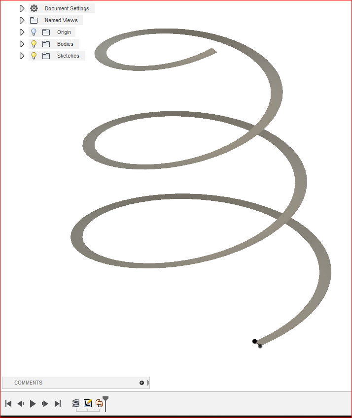

I'm trying to create a coil for a type of mixer, 200mm diameter, 3 revolutions, 250mm high with a -10 deg taper.  The coil is square sectioned, (2mm), and I have no trouble creating it but I cannot adapt the coil to create wider fins, 10mm at least.
If I offset the inside face of the coil, after 5mm the geometry fails.
If I try and sweep a profile from the bottom of the coil, (my preference as I can play with the profile shape), either it also fails or I get unpredictable twisting and edges.
Finally, I am suffering numerous crashes when either creating or editing coils, as happened when I was trying to record a screencast for this post.
Help would be appreciated.

You need the coil, as you have described.
Then sketch the 10mm flange line, connected to the vertex of the coil. (or the flange profile for a solid flange)
then Sweep with Rail and Guide Surface, in the patch area for a surface, like this, (coil is hidden)
Might help....

HughesTooling
How about making the coil section wider then press pull the top face to make it thinner? This started as a 30mm square section.

-Nick-
Ha ! That actually worked pretty well and I got the shape I wanted.  I didn't get to design a fancy profile but for the moment that's not an issue and maybe it never will be.  Thanks!
Message 8 of 21
-Nick-
... spoke too soon.  When you offset the upper surface the offset is actually created at a weird angle so that if you reduce a 25mm section by 23mm, you actually end up with a wedge shaped profile rather than a flat, 2mm thick coil.
To finally get what I wanted I created a 25mm section, copied it to 2mm above itself and used it as the tool to cut the original using the combine tool.

HughesTooling
Looking at the coils made with press pull the wall sections are not consistent. They vary from about 1.98 to 1.83 so to get an accurate thickness you might want to extract one of the surfaces and thicken, see attached.
