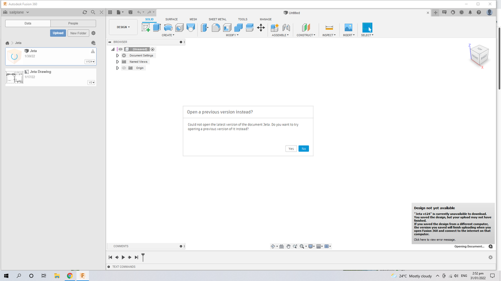

When i try to open latest milestone, i wont, see photo bellow.
I havent seen this before after 8 months of using fusion. My routine hasnt changed when closing and opening the software.
I was hopping to do some work, but this programme is holding me to ransom i feel

If i go into Milestone 123, i cant save any  work i do ( ie. the grey disc i extruded , see picture).
Fusion then prompts me i have a more recent milestone. ( fare enough, but what if the newer milestone wont even open?)
I also cant choose to open the newer milestone 124, fusion just says it's not available at this time again

From the alert messages on the right corner, it would appear the latest version of the file is stuck in the upload queue.  Could you please send us your Diagnostics Logs? From the Help menu, click "Support and Diagnostics" and then "Diagnostics Log Files".

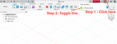

Please follow the below steps:
  1. Launch Fusion 360 and switch to manual offline mode(Please refer to attached snapshot to know how to do it)
  2. Open Jeta.f3d from the side panel and make some changes to it.
  3. Save Jeta.f3d and close it.
  4. Switch to online mode in Fusion 360

I cant get to to step two, because im off line, i cant access Jeta.f3d in the left side bar.
(And i have tired this previously, but the file wont even open, nor will it save)
the file isnt saved to my hard drive, as far as i know, it must be on the cloud??

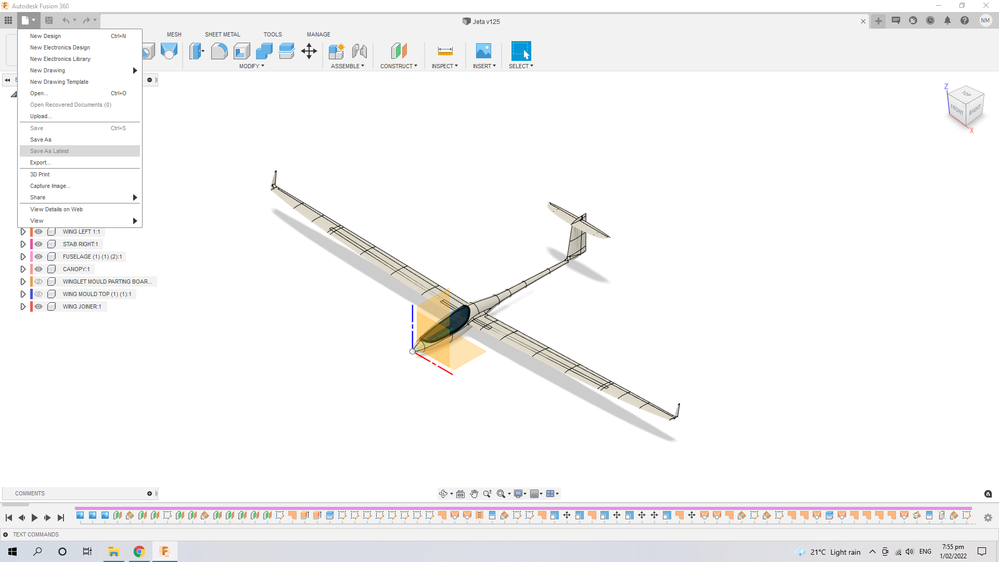

Yogesh i think i have been able to open the previous file, and then i was able to "save as latest".
this over wrote the current version ( i didnt loose anything from the current version) that failed to upload.
I made a small change to the model, then saved it as a new milestone.
I then waited for this to upload, then closed fusion.
I have reopened fusion now and opened the new version successfully!
