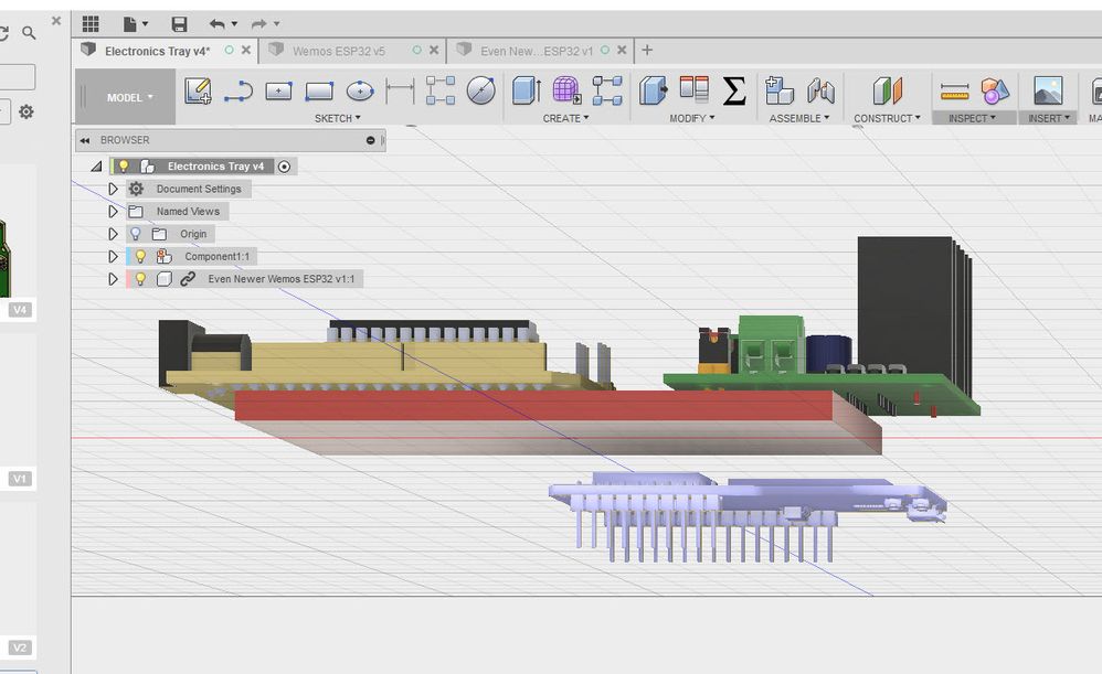

Phil.E
I'll try the workflow.
Just to be clear, your image with expected spacing is measuring a file called 'Test - Wemos...', but in your second image the linked (after insertion from data panel) the giant file you are measuring is called 'Wemos...'.
Did you perhaps insert the original file that was already 10X sized? What happens when you insert 'Test - Wemos.."?
Phil Eichmiller
Software Engineer
Quality Assurance
Autodesk, Inc.

Phil,
Thanks for the rapid reply!
EDIT / UPDATE:
Phil, I just went back and double-double-checked. And this is what i find. (Not bothering to upload photo since it's the same..) When I go through the steps you outlined, the mesh imports apparently correctly. I can measure the space between the pins and all seems correct. When I go to USE it however, it imports with the 10X size. Also, if I simply re-open the part that I created, it also opens with the 10X size.
So yes, there is a separate image from an earlier attempt today, but the results / issues I'm reporting is still the same.
Thanks for noticing.
John

Phil.E
Thanks for the update and I'm glad it's working. I just tried the workflow and found it to be working as expected. So I'm glad we are not seeing different results.
For the record, here are the steps I took:
1. Download the file from thingiverse.
2. Start a new Fusion 360 file and use the Insert > Mesh command from the Insert menu.
3. Pick mm units in the insert dialog.
4. Save the file.
5. Start a new file, and units don't really matter (I confirmed this using inch units in the destination file), save it.
6. Right click on the file you just saved in the data panel, pick Insert.
7. Measure inside the inch file, and I find the pins are 0.100" apart, which is 2.54mm.
Thanks and since you were getting some strange results, please let us know if you see this problem again.
