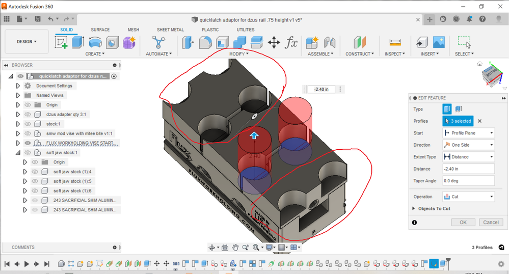

Trying to cut out a feature by selecting a profile and extrude cutting.  I have 2 profiles selected, and im getting way more cuts than profiles selected.  Any help?
Profiles selected
Result I get if I extrude cut
If i select new body, I just get 2 objects only, but if i select cut i get total 8 cuts.  HELP!

almost certainly, this is because you are cutting a component that has multiple instances.  All instance of a component share the same geometry, so the cut in one instance affects all instances.

@jeff_strater hit this one on the head without looking!  The Screencast shows you have multiple instances stacked on top of each other.
I get these extra random cuts
and if i complete the action i get this result?  and thats because i have multiple instances?
rolled my history marker back, deleted those extra instances, re did the cut and same thing.  dont think the multiple instances was the ansser

The instances are the reason for what you are seeing.  Component instances share the same geometry, no matter when in the timeline you have made that geometry.  It's just the nature of Components.  The reason why instances share the geometry is for efficiency.  If you have 100 instances of a component,  because they share the geometry, you only need one copy of the geometry, not 100 copies.
If you do want to modify just one instance,  you have to break that link.  Copy/Paste of a component creates instances of the component.  Copy/Paste New creates an independent copy.

Ok that worked.  Thank you
