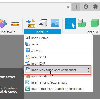

Has McMaster-Carr been removed Fusion 360?
The knowledgebase still references it:

jhackney1972
Nope, the McMaster-Carr Component option is still under the Insert drop-down.

jhackney1972
McMaster-Carr is still available under the Insert menu using a Fusion 360 Personal License also.

Bjanders
It didn't show because I was in offline mode. I was in offline mode because of the Server Verification Warning:
That I just added some info to in this topic:
https://forums.autodesk.com/t5/fusion-360-support/unable-to-validate-a-security-certificate/td-p/104...
Surprisingly though, the two other "insert part" options were available in offline mode, but not McMaster-Carr.

ansaldijoshua
Community Visitor
Community Visitor
I have the personal license, but under the Insert tab, the McMaster carr component is shaded and not clickable.. How do I fix this issue??

TheCADWhisperer
@ansaldijoshua
Change to Hybrid Modeling.

ansaldijoshua
Community Visitor
Community Visitor
Thank you! Worked like a charm!

jhackney1972
You must be in Assembly Mode to use the McMaster-Carr feature. It is logical, you cannot add "components" in the Single Part mode of Intent Driven Design.
