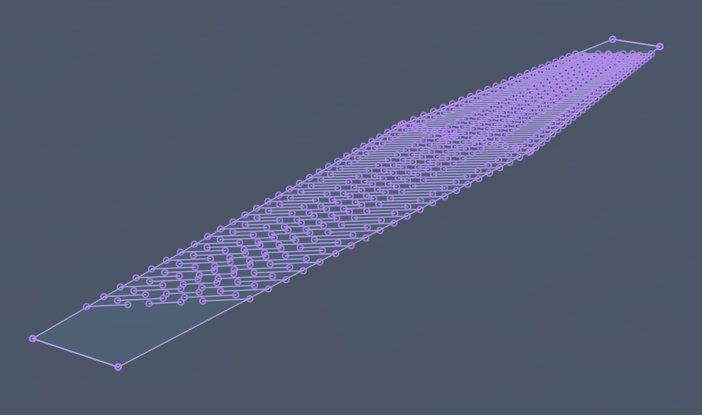

Hi All,
I'm currently experimenting with living hinges in various laser cutting designs. I would like to make a living hinge pattern that expands or varies in width depending on the sketch elements. It seems like it should be relatively simple to do in a sort of parametric pattern, but I'm struggling with how to do it in Fusion360. I've made a simple example for this post. I would like to make a simple living hinge pattern where the width of the individual lines in the sketch expands/varies depending on the contour of the part. I've attached photos. I would like to make so the horizontal cuts of the living hinge are equal length (per row), but each row width can vary. I know I can 'brute force' it by manually constraining each row, but I figured there could be a smarter way?
Hope you're able to help or point me in some direction, thank you!

Hi! I believe you are talking about Fill Pattern. Essentially, the selected geometry will be populated within a selected boundary. At the moment, Fusion does not have the ability to do that. I have heard some internal discussion about it.

Yes. I'll try to explain from this example. So I'm attempting to make a straight line based living hinge on a not square part. I would like to have all lines in the same row to be of equal length, but as the part expands in width each row will be of different width, and therefore the lines width on each row will be different (but equal to each other within the same row). Essentially I would like a pattern like this to repeat downwards where the lines width automatically adjust compared to the width of the part in the specific row.
 You can see my brute force way of constraining it here. I would like to keep the gap between the lines constant and also the distance between rows (these are controlled by user parameters):
And ideally I would like the pattern to repeat over the entire part here so it acts like a living hinge:
Does this clarify my design intent? It is for laser cutting, so I really only need the lines, which is why I have been using the sketch mode. Should I make it a thin extrude instead, and pattern the feature? How would that work?

I spent the last few hours filling it out the 'manual way' but with an angled pattern instead of horizontal. Ideally I would like to be able to create this pattern from a few variables:
Angle, Gap between lines horizontal, Gap between lines vertical, number of rows, cutting overlap (at ends).
I would look at it like a parametric programming problem essentially and I am searching for a way to do it smartly in fusion360. I can do it manually, sure, which works fine if I only have to do it once. But for every following iteration this would be a pain to update with all the constraints and dimensions you can see here.
