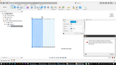

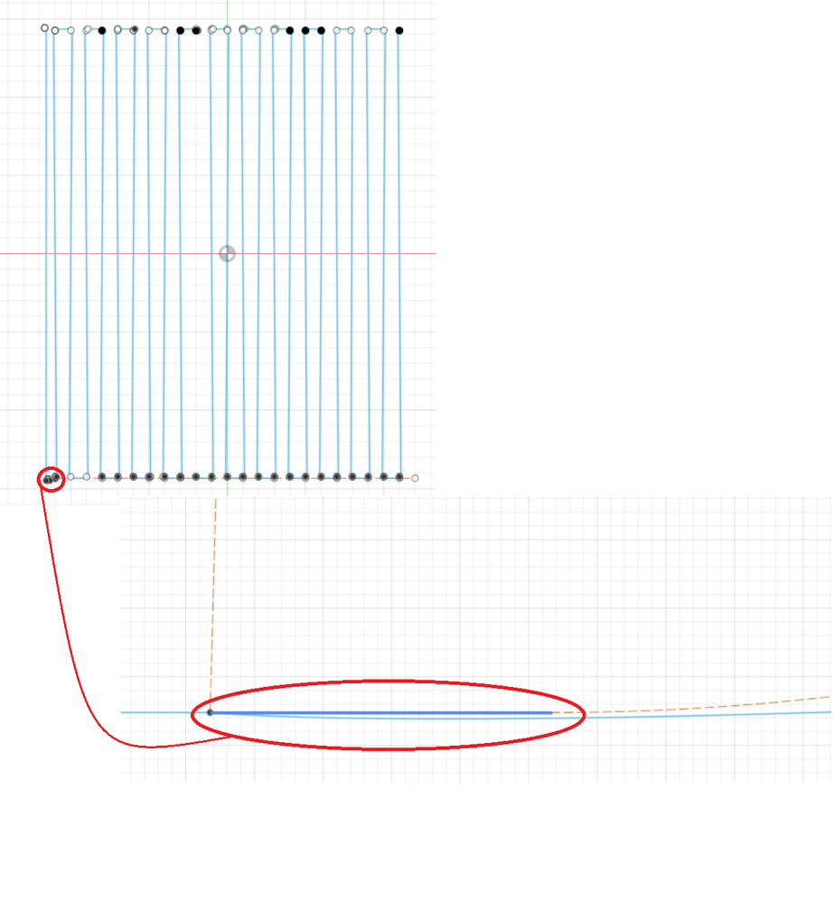

Hi, I am having difficulty in drawing a pipe (it's a circular section wire in my model) in the attached model.
I'm going to try to make my first screencast .. how can I identify which segment has the anti-parallel direction? it's annoying and I am ripping out all of the segments and it is still there. How can i ensure anti-parallel segments don't show up, or how can I fix it? I did try to use SPLINE curves, but those are not suitable for the 'straight" lengths of wire I want to show, use, and calculate with.
I had recorded audio, and it is on the screencast actual video, but during upload the audio went away. sorry.

What is the purpose of this extraneous line?

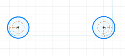

Is the Spline supposed to be Tangent at both ends?
What are these circles?

  4. What is the purpose of this extraneous line? I didn't realize that -- have to check
  5. Is the Spline supposed to be Tangent at both ends? SPLINE is very difficult for me to grok, despite it's purpose, what are the real ways to get a STRAIGHT line if you wanted to while extending the spline, or is it that all SPLINES are curves, and the only way you can get straight lines is to use the LINE tool. Then,could I not make a sections of straight llines (representing the tight curve around each guiding screw and then use (which?) tool to smooth them with respect to each other?
  6. What are these circles? Those are the outer edges of the washers and screws, the wire has to be away from them, but placed in the middle in order to be sandwiched gently to the base NIR-RR frame. If you turn on the shaded view, you will see that the washerse are not coincident with the frame, they are 0.06in away from the frame, which is where the wire will be snugly fit. it's important for this application to not have kinks in the entire wire of about 66ft, of which a fair portion is held by this frame. The remainder will be going to another antenna element in a straight line.

@TheCADWhisperer I used your .f3d file example (copy of my sketch with a missing vertical) and then completed the vertical using the line command (TOP > BOTTOM) and then ran the PIPE TOOl again. This is what I got:
Error: The given path is not tangent continuous around tight corners. To make self-intersecting sweep work, the circular path segments should be tangent continuous to the adjacent path segments.
So, what are the best practices to combine curves with straight sections in a rectangular pattern while sketching?
