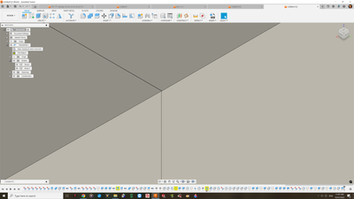

I found a flaw.  Its tiny, that is maximum zoom.  Can Fusion end up with rounding errors?
I got rid of the flaw and tried again and it worked.
Do you think a flaw like that would ordinarily be found and eradicated through the design history?

My other component has four bends, three of them don't work at all and the other does something weird.  I just found another flaw the same as i found in the other component, refer image in this post.  I have noticed in the past that when a sketch line is made tangent to a circle the line doesn't always actually touch the circle, when you zoom in on it and look closely.  I think this is the cause of this issue.    I think this issue has cursed me in the past, but the issue is now much more prevalent.  I hazard a guess the program has been altered in some way making it worse.

Line is tangent to the circle and coincident to the quadrant.
Your graphics issue observation  is as old as CAD itself.
(Search AutoCAD VIEWRES)
