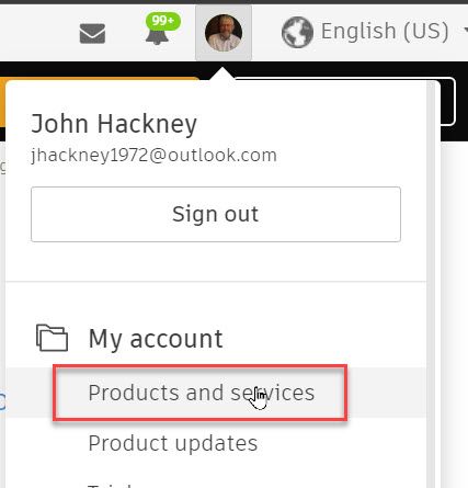

I do not have a Educational License but I think, it is worth a try, you need to go to your Autodesk Account, Products and Services and find the Generative Design extension hooked to your Education License and activate it.  You can get to this page quickly by using the following from any forum page if you are logged in.  DO NOT forget to restart Fusion 360 after you do it.

Hi @jhackney1972 ,
Instead of being able to activate the Generative Design extension upon trying click on the access now button in generative design extension column, I am being redirected to the generative design webpage of autodesk.com

If you have an educational license and sign into Fusion 360 with "your school DOMAIN email" as you Autodesk ID, you will have access to Generative Design.  If you are using another Autodesk ID, you will not.  Your log-in should look something like this not just EDU by itself.

That's correct. It solved my problem. Thank you!
