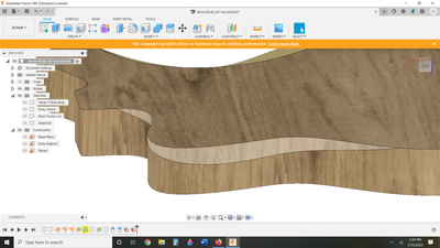

I'm VERY new at Fusion 360. I'm working on a guitar body. I inserted a DFX, which I exported from V Carve Pro. I then extruded it, but the extrusion seems to exist as multiple pieces. I'd like to be able to click on the entire extrusion with one click.
Sorry if this doesn't make sense. Like I said, I'm very new.

can you explain a bit more what you mean by "multiple pieces"?  Do you mean multiple faces?  If so, that is an effect, likely, of using DXF.  Some DXF exporters push out a LOT of small curves.  But, I think we need more info, including maybe the model, to say for sure.

sorry for the delay.  Yes, the picture came through this time.  I can see what you are talking about.  It is the multiple faces around the body.  And, yes, this is because of the use of the DXF for the body outline.  That DXF geometry is not going to be directly usable.  I would recommend that you re-draw the outline using a fit point spline or a control point spline.  It should only take a few minutes, and the results will be much better.  If you share the DXF here, I can demonstrate the process.

Thank you for your response and thank you for all of your help. I kind of figured that was going to be the case, so I took some time to learn about using control point splines. I'll be sure to ask more if I need help.
