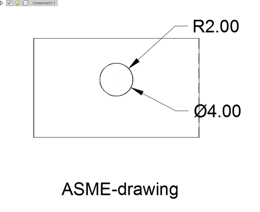

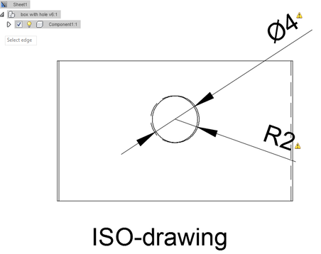

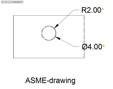

Interesting observation. The (Fusion 360) ASME and ISO algorithms obviously have different tolerance values for "interpreting" ellipses as arcs/circles.
I tested it with a box/hole component created with an angular construction plane. Dimensions created at 0°, then I changed the angle of the construction plane.
Results for 0.1°
-> ASME: no warning, you also can create new diam/radial dimensions
-> ISO: warning, new diam/radial dimensions don´t accept geometry
Results for 0.5°
-> ASME and ISO: warning, new diam/radial dimensions don´t accept geometry
paul.clauss
Hi @Anonymous
Thanks for posting! The ASME and ISO templates do use a different tolerance, which I believe is the cause of this problem for the OP as well. We appreciate your input - I will pass your post along to the development team for further investigation.
