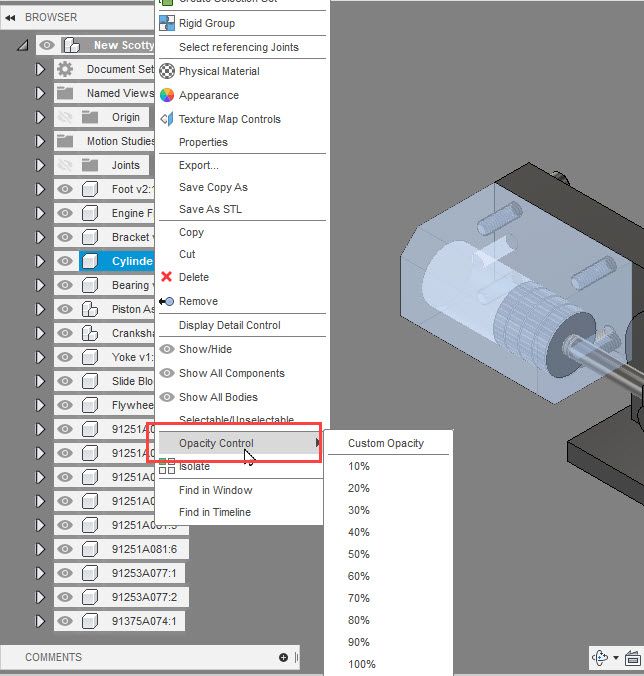

I just noticed this happening today, in some of my existing assemblies and in new ones, there are parts that are maybe at 50% opacity and some that aren't.  I've tried changing the visual style and the affected parts stay transparent.  When I open the part alone, it does not have the issue.  I am running Fusion 360 for Mac 2.0.8816 on macOS 10.15.6.

You can set the Opacity per Component in the assembly, maybe this is what you are seeing.

Yea I tried looking for the opacity setting but it is not in the menu when I right click on the component.  I don't know if the component has to be created in the assembly or not to have that control.  These components were created separately then dropped in.  Also I just closed Fusion and reopened and cannot recreate the issue.

I spoke too soon, it is still happening but I'm not sure what triggers it.  If I close all files and reopen, the issue will go away for a while.
