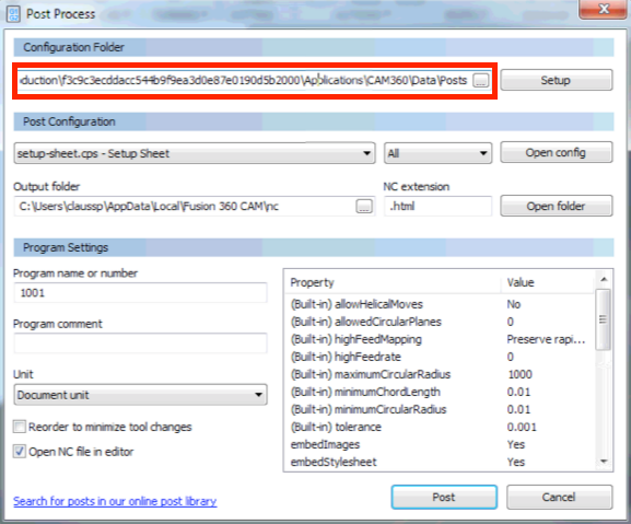

Thanks for posting! I did a test and noticed that the Setup Sheet button does link to the generic Setup Sheet post processor in Fusion, so replacing the existing setup-sheet.cps and .css files allowed the Setup Sheet button to include tool lengths by default.
Your generic post folder filepath can be viewed in the post process dialogue when working on Windows (as shown below), and in the  /Users/MyName/Library/Application Support/Autodesk/webdeploy/production/version hash/Libraries/Applications/CAM360/Data/Posts folder on Mac. The version hash will be an alphanumeric string - this string can vary from user to user and there are a few folders in the Production folder that are labeled alphanumerically, so you may need to look through each one.Screen Shot 2017-08-13 at 1.09.40 PM.png

Thanks for the information, the only difference that I found was that my
location on my work station was a little different
C:\Users\mark_new\AppData\Local\Autodesk\webdeploy\production\f3c9c3ecddacc5
44b9f9ea3d0e87e0190d5b2000\Applications\CAM360\Data\Posts
But by enabling the search of the application data folder it found where it
was at. Thanks everyone for your help. Tool length during setup of the
machine is extremely necessary with the type of cutting that I do that if I
set it wrong I will have a crash.
Thanks, Lee McLain
