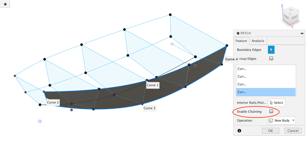

jeff_strater
turn off "enable chaining".  Then, you control directly what is selected:

peter_humphreyMC8KJ
Thank you Jeff! So easy when when you know! I could have sworn I unchecked that and tried, but probably in the middle of a string of unsuccessful clicks on various things.
