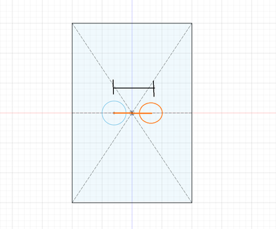

I don't know the terms, so I am kind of flying blind.
I have a sketch.   Rectangle.
There is a construction line across the middle (vertical) from left to right.
I have a parameter called "DistanceBetween".
I want two holes on this middle (center) line.   With "DistanceBetween" the distance between them.
So the blue circle is what Fusion has.  The orange line and circle are what I want.
The black line is "DistanceBetween".
I get that the distance from the center point will be "DistanceBetween" / 2.
Then I mirror it.
But HOW do I set the "constraint" to move the center of the circle to be "DistanceBetween / 2"

davebYYPCU
Draw 2 circles, make them equal with Equal constraint. Dimension 1 of them
Join the centre points with a line,
Dimension it with "Distancebetween"
Use Mid Point constraint on the line and snap to the Origin.
Make the line horizontal.
Order of operations as it suits.
Might help...
Obviously you are not snapping to the centre point. Cursor changes to blue square when you get there, (or drag centre point to end of line)
type of line? It's your choice, 3 types to choose from all have the same effect.
Might help...

davebYYPCU
Nope, for this stuff, all the same in either version.
Editing a sketch, you get his toolbar,
click on the triangle (Midpoint)
click on the line
click on the origin.
Don't forget to make the line horizontal.
Might help...
