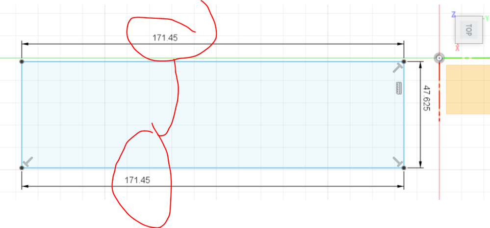

TheCADWhisperer
Do you get expected results if you Combine the bodies (see Attached file)?
Why is there a duplicated dimension in Sketch1.
I recommend that you fully define you sketches, especially Sketch1.
Message 8 of 14

TheCADWhisperer
@levi-textor wrote:
What duplicated dimension do you mean? I can't see this in my Sketch.
 Your first sketch (actually your first sketch is Sketch4, so you must have made a few mistakes earlier).
This is about as basic as it gets - have you gone through the Tutorials?

levi-textor
As I said, I'm pretty new to Fusion 360.
I've done the Tutorial, yes.
But is this really a problem there?
I mean it is not necessary and looks weird,
but I thought this wouldn't cause any problems?

TheCADWhisperer
It is not a problem - but indicative of a generally poor understanding of the software.
When I see something like this (and especially when I point it out and the creator says, "I can't see this in my sketch"), I expect to see issues that are problems in how the geometry is created.
Use the Origin (especially for any existing symmetry).
Fully define your sketches.
Use body or patterns.
