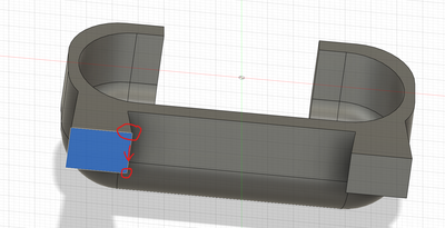

I have an object drawn already and I set an Offset place against the piece I want to draw on. Issue is when I start a sketch I cant get any sketch object (line, circle, rectangle etc) to snap to the corner of an object like I want. I know there is a way to do this that is fairly easy but im still learning and not very familiar with Fusion 360.
For reference, I am setting an offset plane on the blue face and I want to draw a line to connect the two corners in the red circles. I just dont see any snap points on the face of the blue object once I start a sketch.

what you need:
sketch mode > CREATE > project/include > Project (or shortcut p)
project edges/points or the body profile
