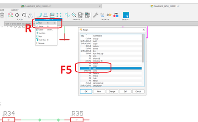

See the following image please. There's a mess in keyboard shortcuts: one function, multiple keys. Shortcuts from Asssign dialog do not work. It looks like nobody try shortcuts before making Fusion release.

Hi @vfprivate ,
I hope you're doing well. I see you called up the ASSIGN command through the command line. The ASSIGN command isn't currently working in Fusion 360, that's why it's not part of the main tool bar. Fusion 360's shortcut system is very different to what EAGLE has so we'll have to figure out how ASSIGN fits into that.
For now, only the hardcoded shortcuts in Fusion 360 work.
