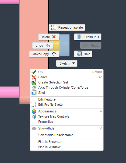

In the past you could double click a body and it's component would be selected, then right click and select Isolate. With the latest version of Fusion 2602.0.71, if the mouse pointer is still over a face when you right click the face highlights so you can't select Isolate.

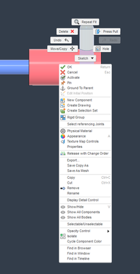

I still have a PC that has not been updated and right click while over a face leaves the component selected.
This is the old version of Fusion after the right click.
And this version 2602.0.71
EDIT. This is also a problem activating a component. In the past just double click a body, right click and select activate. Now you have to find a clear space on the screen with no faces before the right click.😖
