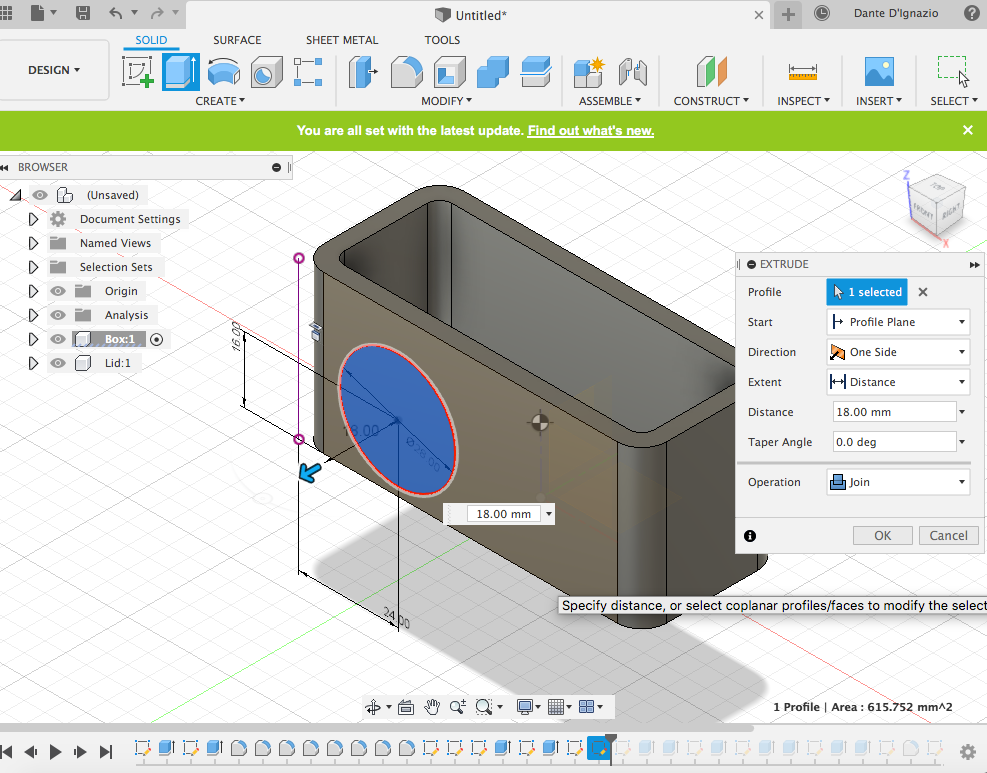

Hey I am following this youtube tutorial and I keep running into an issue with pulling the first circle. There is these lines and a beige colour on the shape that I am trying to pull. I first ran into this issue when I tried to "Inspect - Section Analysis" and now its defaulting with this movement.
When I pull it, the image does not display any material being pulled. Its registering the numbers but nothing happens when I complete the action.
Has anyone ran into this before? its very frustrating 😡
Thanks for the help in advanced.

TheCADWhisperer
What happens if you click the eyeball next to the Analysis folder?

We need your data to teach.  We don’t know why it defaults to the bottom, shouldn’t happen, but without your data, we can’t help with your data problem.
No matter, if the Sketch is on the bottom - you can still make the cylinder with what you got,
Extrude > Two sides.
For the first side, click the top face, for the second side adjust for the bottom face, slide the handle up to the same result.  Bit advanced but keeps you going.
