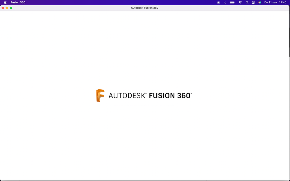

Since a couple of days now; i cannot use F360 anymore on my 13" M1 Macbook Pro. Whenever i open the app and it starts to boot, i get to see the splash screen, a big white window; and then the whole app freezes and i need to Force Quit it or i get to see only the macOS beachball.
Any tips / tricks / workarounds? It's really annoying..
