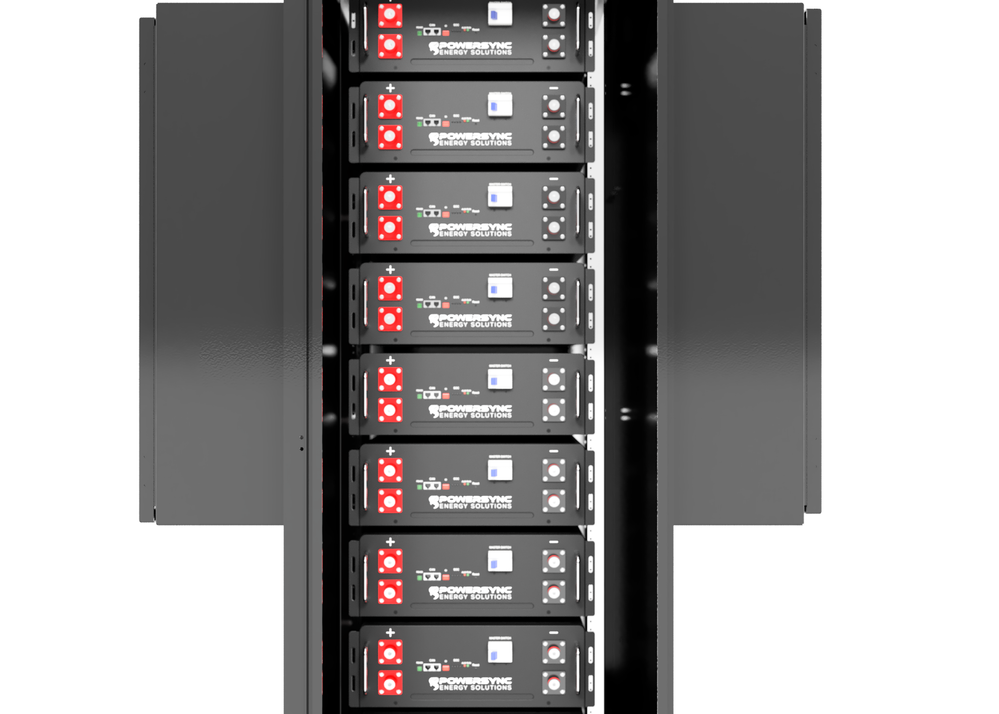

I apologize in advance for the length of this post. I'm having issues with rendering images from Fusion 360. At least, I think I am since I'm not getting the results I expected. I have an enclosure with ten pieces of electronic equipment inside. I need to provide renders of the enclosure at different angles and zoomed different amounts. Here I'll post some examples of what I'm experiencing from one angle.
At first, I tried using the local in-canvas render. For small, single-piece items, I typically let it go 20-30 iterations. For these, I let it go more like 50-75 iterations. This worked okay for my client's immediate need. Okay, but not great. But then he also needed to be able to zoom in on the images and still be able to see the images and the wording in the images clearly. In the past, we weren't able to purchase cloud credits for cloud rendering, but apparently we can do that now. So I bought 100 credits, assuming that would resolve the issue. Well, it hasn't. Here I'll show some images that I've rendered.
These first three are the exact same view, rendered in different ways. For this first one, I used the Print cloud render setting of 5x7" 300PPI (3 cloud credits).
For this second one, I used the Print cloud render setting of 8.5x11" 300PPI (8 cloud credits).
For this third one, I used the local render at about 50 iterations (0 cloud credits).
Obviously, the first one is the lower quality, but it is really hard to see any difference between the other two. I honestly have a hard time deciding which one I like better. Yet one was free and the other one cost me $8. What's the point of paying for higher quality renders if I don't actually get a higher quality render?

I guess I didn't really say exactly what my questions are:
  • Why are cloud renders (that cost money) of equal or less quality than local renders?
  • What do I need to do to actually get better quality images?
Thank you.

In general it is not really that easy to make the flat front panels of such devices look interesting. There seem to be very few fillets that can provide highlights to help the eye and the materials are pretty flat and have no visible texture.

I have tried different environments. In any case, if I turn the brightness way up, it helps. The issue isn't so much with it looking "interesting." The issue is that it turns out grainy and blurry. So far I think the thing that has helped the most is the depth of field and the blur settings in the scene settings.
While I'm here, another question in regard to this is about the ground plane. If I turn the ground plane on in the scene settings, the shadow shows up on the "ground," but the shadow doesn't render in the image. Is there a way that I can get the shadow to render in the image?

Without having access to a design I can't really help. I cannot say that I've encountered such problems, my cloud renders turn out very crisp.
Message 8 of 8
TrippyLighting
Try to render without a ground plane and let us know if that makes a difference.
