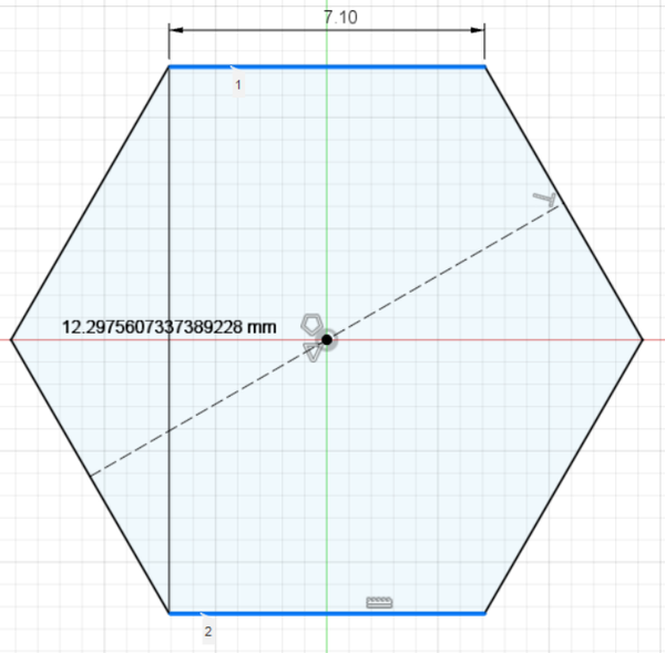

How does Fusion detect the spacing if you don't manually enter it?  I always select "Measure" and it seems to work it out.  When I select "Measure" it doesn't space correctly.  Is there an auto-spacing feature so that its not hard measured?
Message 13 of 24
You found it.  That is exactly the problem.  Fusion bounds the original hexagon correctly, but when it patterns, the points no longer coincide.  If I add 0.001 to the hex side it patterns correctly and bounds the replicas.
Message 14 of 24
TrippyLighting
@Anonymous wrote:
You found it.  That is exactly the problem.  Fusion bounds the original hexagon correctly, but when it patterns, the points no longer coincide.  If I add 0.001 to the hex side it patterns correctly and bounds the replicas. Real
 LOL!
The mathematical formula to calculate the amount of movement for the pattern instance is:
(side_length * sin(30) + sketch_offset) * 2
If you plug that incredibly complex mathematical formula into the pattern field and reference the parameters for the dimensions you used in the sketch it looks like in the screenshot below and surprisingly it works and is fully parametric.

What do you see when opening the file I had attached ?
If you had used "all digits" when copying the measured value you'd see the same result and there's no problem.
3 digits accuracy is OK for manufacturing purposes, but in this case you'll have to adhere to the precision the CAD system requires to operate properly.
