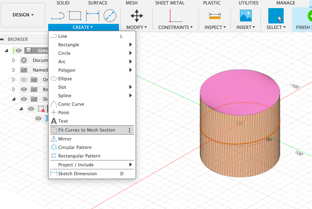

I've recently been attempting to undertake some reverse engineering projects and wanted to use the Fit curves to mesh section tool. Though it doesn't seem to be available or even listed anywhere? It was my understanding that this was available in the basic version of fusion though I may be mistaken? There is no listing for in New Sketch>Create  not even a greyed out option. Any Ideas? or maybe I'm missing something simple?

I think that this command only appears in the toolbar if you are editing a sketch that contains one or more mesh sections.
Screen Shot 2022-10-24 at 6.29.52 PM.pngScreen Shot 2022-10-24 at 6.29.02 PM.png

Ah I see. ive got it working now, thanks for the help!
