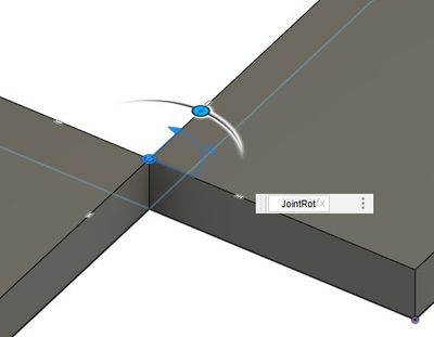

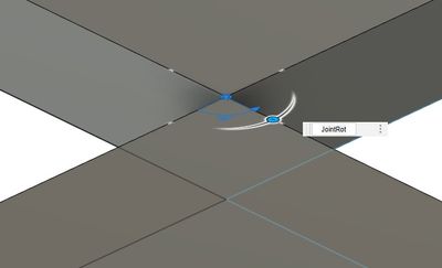

I'm assigning a User Parameter to a Joint, as its rotation value. When I click "Compute All" to update the rotation value (changing the user parameter value does not update automatically), the assignation of that parameter to the joint is removed. This happens to all the joints in the document, if there are multiple.
Steps to reproduce:
1-Create a simple hinge Joint between two components and a parameter of type deg and value of 90º
2-Assign the parameter to the Rotation of the joint
3-Click Modify->Compute All(Ctrl+B) 
4-Check the Rotation value, the parameter is no longer assigned

That would be difficult... I'm using a model with Ball joints already applied (the revolute joint shown here is a simplification to better illustrate the problem, that also happens with ball joints), and the rigid joint does not allow 3 axis of movement...
Message 6 of 12
The user parameter is, as far as I know, not "actually used" in the Joint, because the rotation angle of the joint is not displayed in the Model parameters, only the alignAngle, which is not the same as the rotation Angle. (I'm actually using user parameters as a workaround to modify this rotation value with a macro, and I intended to do so using the model parameter (d9), but that is not the angle I want to modify)
Picture below with the UserParameter Assigned to the rotation Angle:

Yes, a parameter there works for me too, but that is the "Joint Alignment Angle", equivalent to this angle in the joint editor. That's why d9 is not referenced to the parameter, because it's not the angle I want to assign to the parameter:
(This one updates)
The one that doesn't update is when I double click the joint in the 3D view and insert the parameter for the angle value there (which is a different angle to the alignment one, different axis), this one doesn't appear as a parameter in the parameter window... maybe it's not intended to be linked to a parameter?
(This one doesn't update and loses the reference on Compute All )
Message 10 of 12
jeff_strater
Ah, OK.  Yes, the current rotation angle of a joint is not exposed as a parameter.  The Alignment Angle is only the initial alignment adjustment here:
Today, there is no way to parametrically drive a joint from a parameter, mostly because component position itself is not recorded as a feature, outside of Capture Position, and that feature just records the transforms of all components that have moved, regardless of the method by which is was moved (joints, move, drag).
