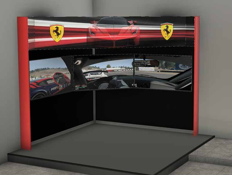

I find anti-aliasing counter-productive on anything with a dark background, as the anti-aliasing artifacts that are created are white. This looks worse in most cases than turning anti-aliasing off.
Here is a magnified corner of my model without AA, a sign with a graphic (decal) applied.
Without Anti-AliasingWithout Anti-Aliasing
Here is the same corner with AA. Note the white dots and lines added to the borders.
With Anti-AliasingWith Anti-Aliasing
Here is the full model, a triple-screen display system with image decals applied to the screens and graphic panels above. The anti-aliasing is horrible and cannot be used for these images.
A closeup...
Is there a way to change the color of the AA effect? If not, does it make sense to add this option or am I missing something about how AA works?

Hi @Paul_Stary
Thanks for posting! It looks like you are experiencing a known issue with anti-aliasing in Fusion 360. This behavior has also been described on this forum thread, and is logged internally as FUS-34544. We appreciate your input on this behavior!
Unfortunately, apart from avoiding the use of anti-aliasing, there is not a great solution for this behavior at this time. I've made a note of your comments on our development teams ticket on this behavior in hopes of increasing the priority. Please let me know if you have any questions - I am happy to assist. I think the idea to define a color for anti-aliasing would be a great addition to the Fusion 360 Ideastation
