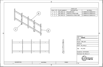

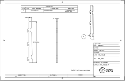

I have an assembly in 3D which I have transferred to a drawing. Page one of the drawing set I have an assembly view with balloons and a parts list. Here it shows my updated part numbers the same as in the 3d file. But once move to my detail pages of each part, the title block does not have the correct part number updated from the 3d file or the Parts list.
this is imperative, without correct matching part numbers.. its impossible to dissern which detail drawing you are looking at and how it correlates to the assembly page.

please see attached examples:
