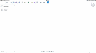

I just tested opening one from my computer and it did open as i'd expect it to:
The same happens for me when i open after uploaded. I can't test the zip you uploaded - its invalid(if its a dxf/dwg it too is invalid)
