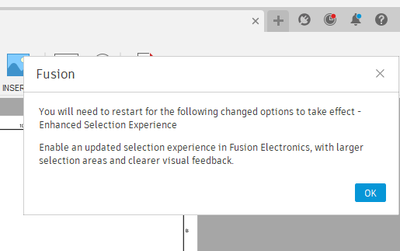

Every time my Mac goes offline, I get the following prompt that I would like to disable:
"You will need to restart for the following changed options to take effect - Enhanced Selection Experience Enable an updated selection experience in Fusion Electronics, with larger selection areas and clearer visual feedback."

I also have this message appear every time the computer sleeps and comes back along with an annoying youre offline message. Sometimes this message appears twice amd this behaviour has only started in the last month or so but its unnecessary and I would also like this gone. It appears like any time Fusion360 gets anyway near fixing any of the 100 or so really annoying issues they decide to throw in something alse to annoy us.

@tm2501B76WC @cprasmussen The message that you are in offline comes up when the compute goes to sleep and the network connectivity is lost. When you come back online it takes a few seconds for Fusion to retry. Until a month ago, you had to manually dismiss that offline message even when Fusion connected back online. We do have addressed it in the last month.
Can each of you confirm which version of Fusion you are using? The latest is 2.0.19983
Also, can you please send us your logs when this happens the next time.
1. Go to launch pad - Fusion service utility - Gather system info
2. Attach the zip files that are generated

I get this on Windows 11 too; each time my PC goes to sleep and looses network connectivity. I'm on the latest Fusion. I have to click on OK, only then will it reconnect, which is almost immediately.

Today we release Fusion V2.0.20256 and the error message should be fixed.
Please upgraded Fusion to have a try, thanks a lot!
