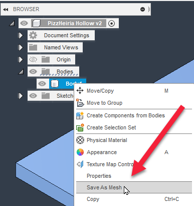

You say you have tried to "Export to Mesh", have you tried to use the "Save As Mesh" by right clicking on the body in the Browser?  Also if this does not work, attach your model and I will test it on my Subscription License.  If you do not know how to attach your Fusion 360 model follow these easy steps. Open the model in Fusion 360, select the File menu, then Export and save as a F3D or F3Z file to your hard drive. Then use the Attachments section, of a forum post, to attach it.

'Save to mesh' unfortunately didn't do the trick either.

The Fusion 360 license type makes no difference, as you can see in the image.  The lattice is not captured in the STL export.

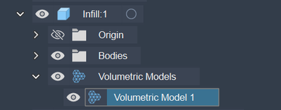

I figured it out eventually, when you create the volumetric model on the body it creates another tab within that for the volumetric model. Right click on the highlighted tab in the picture to convert to mesh. I was able to export it properly to an STL after this.
