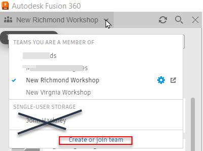

You cannot acquire Configurations if you are still using a Personal Hub for cloud storage, you must be using a Team Hub.  It does not matter if you use Fusion 360 just yourself.  Here is the article I cut the screen capture from.
Edit: There is no cost to create a Team Hub.
When you do create a Team Hub, you will want to read this webpage to find out how to move your files from your Personal Hub to your Team Hub.  There are so many advantages to having a Team Hub.

nocturnalwelding
Hi, I have subscription and was able to find it on a old team collaboration that I did with a customer, No idea how i made that years ago.  When I click on create or join team it tells me.
" we couldn't find any teams that you may like to join based on your email address. IF you know the name of a team you'd like to join, contact its administrator for an invitation"
I'm just trying to make a team so I can check out the new configurations feature, Also this information would be nice incase I need to collab with a customer again. Thank you
