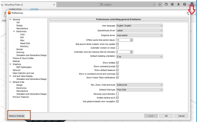

Changing the stock tolerance value is easy. This parameter does not have to save as a user default feature as other parameters had in cam, instead of that last entered value will be remembered or stored for further simulation purposes.
In order to avoid Fusion crash during simulation, try the below two solutions,
1. Turn off Automatic In Process Stock calculation under Utilities.
2. Update the latest graphic driver. Click here to know more
FYI - The restore defaults under preferences will vanish all the preferred settings to original as per Fusion 360.
