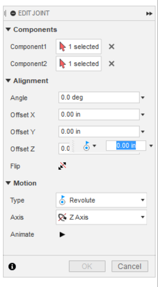

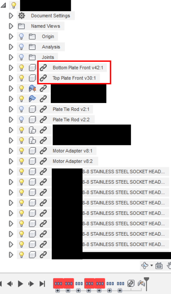

Good morning everybody,
The June 11th update brought a bunch of goodies. I'm on the other hand experiencing a major bug that is affecting my workflow efficiency substantially. All the mirror operations lose the original components as a reference when said components are updated. This results in all the joints referencing the mirrored components to be broken. It happens in all the assembly files I have created, no matter the workflow followed. You can see the problem in the screenshots below.

I generated two new files to reproduce the effect in a different project. I can create the same problem in an assembly file if needed. You can find the links below. Let me know if that works.

Thanks for posting! I was able to reproduce this in your file as well as in a new file after seeing your setup - thank you for sharing.
I've logged an internal bug ticket for our development team to investigate a fix for this (internal reference FUS-40868). We appreciate you bringing this to our attention!
I did find that I saw no problems when I mirrored the component in the child file, as opposed to mirroring the x-referenced component in the assembly file. This won't be ideal in every design situation, but may allow you to avoid this issue while a long term fix is developed.
The problem appears to be that the mirror feature loses reference, but does not show an error. You may also be able to work around this by editing the mirror feature in the design timeline and reselecting the component to mirror.
I hope this helps! Please let me know if you have any questions.

Thank you Paul. I have never seen this happen before this update. I am currently working on other stuff in parallel since my assembly files contain many parts, and this specific problem is affecting a part that I have linked to many others through joints. The problem of reassigning the part in the mirror feature is that the mirrored part is generated as a new part in the assembly, so all the joints created against it get broken.
I use this feature a lot with parts that are very similar but mirrored, to avoid having to keep modifying two different parts whose design has only subtle differences. This simplifies the design when you several iteration steps to get to a final design, before splitting the two parts apart.

jeff_strater
@Anonymous, @Anonymous:  We have elevated the priority of this.  Once we find the bug, we will try to get it into a hot fix update as soon as possible.  Thanks for reporting this.

Message 12 of 15
That was actually faster than I thought. The update that rolled out today seems to have taken the problem away with it. Thank you very much guys!
