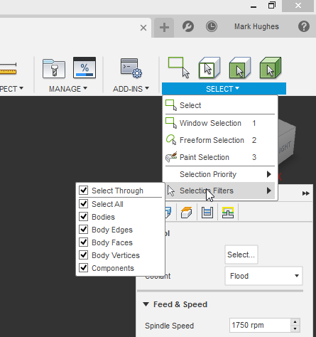

@James.Youmatz  This is pretty easy to reproduce. Just create a body in the model workspace, go to selection filters and turn all off. Go to the CAM workspace and create a set up, then create a 2d profile and try selecting an edge. You'll find all selection filters off, now enable all filters and you still can't select an edge will all filters on. From my tests the filters in the CAM workspace do nothing at all. There are some missing as well as you don't have filters for sketch geometry so you can't prioritise sketch elements.
Here I've disabled all filters in the model workspace then enabled all in CAM but can't select. I'm using the new UI in case that's different.
