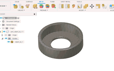

Hello everyone! I have been studying this problem all morning, but have not yet found a solution ... Last night I did a similar procedure for converting stl to brep, and everything worked! In the morning, when I started the program and opened the same stl file, the operation is lost ... I also noticed that a cover automatically appears on top of the imported model, and the color of the model also changed ... Capture design history is disabled, and there is no mesh menu in the modification menubrep1.jpgbrep2.jpgbrep3.jpg

TheCADWhisperer
Expand the Bodies folder in the browser.
What do you observe?

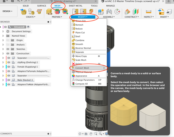

jeff_strater
It is in the Mesh tool tab, under the Modify menu, the command is called "Convert Mesh"

Phil.E

Message 40 of 46
Thank you for responding, but that screen isn't what I see.  I have attached screenshots and the file I am working with.
