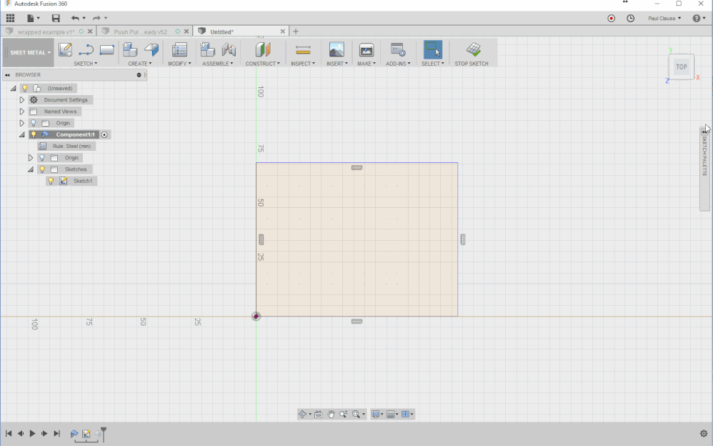

Thanks for posting! It could be that;
  1. You are not actively editing a sketch, so the constraint panel will not be shown.
  2. The sketch palette/ constraint panel could be minimized.
  3. The sketch palette may be on a separate monitor.
I've shown how to show and hide the sketch palette, as well as reset Fusion to its default layout under the file menu. I hope this helps! Please let me know if you have any questions.sketchpalette.gif

I apologize for my belated response. it's not that I don't appreciate the help, I just have to much going on.  The explanation was excellent, including the graphics.  That being said I wish I was a better learner, I did not realize that menu display was dependent on implementing a drawing (L)- i.e.).  I should have realized that earlier and I would have not have been re-explained in the text.  I am extremely delighted that my question was answered with such expertise..  Kudos and  Thank you.
