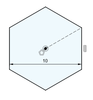

I recently discovered that the sketch solver can solve for pattern parameters such as spacing, center of rotation, or direction. Wow, this is a wonderful and really powerful feature!
I've seen a couple of anomalous behaviors, though. Here's one that's consistently reproducible and clearly wrong. Start with this sketch of a fully-constrained hexagon:
The goal is to create a pattern of three hexagons along the construction line with spacing such that the corner points are in contact. Previously I would have thought it necessary to calculate the corner-to-corner diameter of the hexagon in order to set the spacing appropriately. But evidently this isn't actually needed! You can put in a dummy spacing value, then constrain two adjacent corners to be coincident, and Fusion 360 should adjust the spacing appropriately:
Then constrain these two points together:
Or at least, that's the way it seems to work in many sketches. But in this case, Fusion 360 just distorts the second pattern element to satisfy the constraint.
Clearly that's wrong. Note that the pattern is still active within the sketch and remains editable. But you can't, for example, change the side-to-side diameter of the hexagon to 9mm; the solver just complains.
(For anyone tempted to go down the "hey, you know you can just dimension the vertex-to-vertex distance on the hexagon..." road: yes, yes, of course. This is just an example to demonstrate the pattern+constraint issue. I don't have an actual need to make rows of hexagons.)

I cannot replicate this issue.  Could you post your model with the sketch BEFORE you add the Coincident sketch constraint?  I would like to play with it a bit.

@jhackney1972 wrote: I cannot replicate this issue.  Could you post your model with the sketch BEFORE you add the Coincident sketch constraint?  I would like to play with it a bit.
Hmm, interesting! I thought this might be one of those Fusion issues that creeps up after the app has been open and in use for a while (in this case, several days), so I restarted the app and in consequence received an app update, which I accepted by restarting a second time. It still behaves the same way for me - I'm on macOS Monterey 12.1.
Here's the file prior to applying the constraint. I have also verified that I can open this exported file and apply the constraint to reproduce the issue.
Message 7 of 9
GRSnyder
Ah, here's a possibility... Is your initial hexagon centered at the origin as mine was? If I just draw a free-floating hexagon and go through the same procedure, I get an "unable to solve" error instead of a distorted pattern element when applying the constraint.

First of all, I am running Windows 10.
Trials:
  1. Opened your supplied file, I could replicate the issue.
  2. Save your file by a new name, removed the pattern but left the original polygon, I could replicate your issue.
  3. Open your file, removed the complete sketch, recreated same size polygon on the origin, added the pattern and could not replicate your issue.
  4. In a new file, created the same size polygon on the origin, did not use the default radius of the circumscribed circle but applied a 10mm dimension across the faces like @GRSnyder did, added the pattern and I COULD replicate your issue every time.  The only difference is the way the polygon is dimensioned.  Screencast is attached.  @jeff_strater this may be of interest to you.
