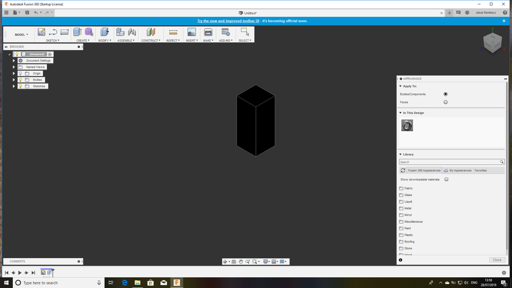

using unlicensed windows 10 in virtualbox.
model appearance appeared as rainbow clown vomit, however rendering a PNG resulted in apriopriate textures being applied.
i now clicked the revert to defaults button for lighting from the render workspace (which carried over to the modelling workspace) and the model appears completely black. i have attempted to retexture the model multiple times. This started by just opening the program one day and extruding clown vomit.model appears completely black now :(model appears completely black now 😞
rendered image is fine despite the clown vomit issuerendered image is fine despite the clown vomit issue

yes, it seems to be an issue with the settings, but i am not sure

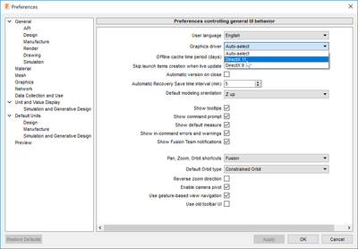

The default graphics driver may not work properly for virtualbox, could you try to change the graphics driver to DX9?
