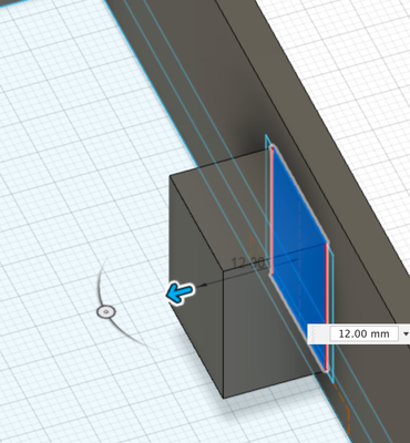

I have a simple sketch and when I try to extrude it, the preview looks great but it always extrudes (or cuts) in the opposite direction.
Selecting to extrude:
Results:
If I select "Do not capture Design History" then it starts working perfectly.  Is there some hidden attribute that could cause this?

It should not work that way, the extrude should follow the blue arrow. Please attach an f3d file of your model so it can be looked at.

you´ve created all your  extrusions in one sketch on the xy-plane. But the faces you want to be extruded is perpendicular to xy on yz.
Create a new sketch (yz) and project that profile.

Fusion does not like the fact that basically you have two separate sketches in one sketch. It is much better to have more simple sketches than one complicated sketch. You also have too many extrudes, you should plan out the model in your head before just putting extrude on top of extrude and hoping to get what you want. I cleaned up the file and you can go from there.

It seems that I found the source of the problem 🙂 Turning the profile in the 3D sketch changes the direction of the extrude operation normal

The only remaining question: Is this a bug, or is this the desired behavior?  If it's the former, what needs to be done to report it?  If it's the latter, can we get a indicator that shows the direction of the normal it uses for extruding?

I am leaning heavily towards this being a bug not only because it shows one direction and extrudes another, but because it's not possible to correctly "cut" with this inversion.  The visualization will only allow you to "visually extrude" in the direction that has something to cut into, but then cuts the other direction.
