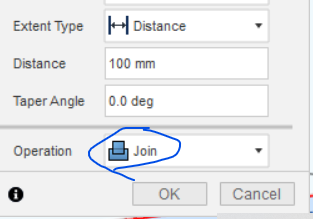

Looking at your previous model - I think you want to set this to extrusion to Join.
