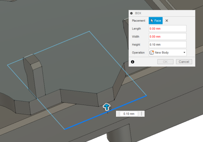

4. instead of generating the body and prompting box height, the dialog prompts for face/plane placement again:
Dialog prompts for placement instead of box heightDialog prompts for placement instead of box height
5. If I follow the prompt and select the face again, the height textbox then appears, but no matter what I type in, no solids are generated, length & width become 0, and the "OK" button is greyed out no matter which values I change (length & width also stay red even if I change the number).
After specifying placement for a second time, height can be input but no solids appearAfter specifying placement for a second time, height can be input but no solids appear

  • If I try to do the above when creating boxes, Fusion only lets me select one of the sides. The default height text box and drag handle appears which I can manipulate, but still no solids generated and OK button still greyed out:
