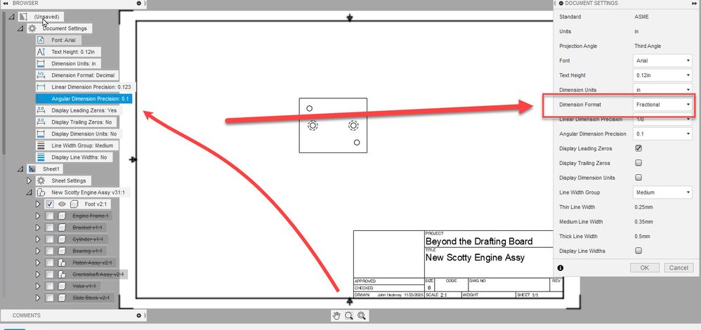

You are looking at an old tutorial, they moved the 2D drawing Document settings.

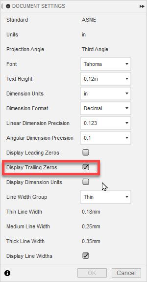

Hi, I'm a fairly new user and am having the same problem. Changed the Document settings per your instructions, but the drawing still shows only the number of decimal places required to express the dimension value (displays .5 instead of .500). So I double click the dimension and get a dialog box allowing me to choose how many decimal places are displayed, but when I click <Close> I still have only one place decimal place shown.  Interestingly enough, it worked correctly yesterday.  I had to re-enter my username and password today when I started F360. Did they just introduce a new version - or am I accidentally doing something differently?

If you want a three place decimal all the time, you have to turn on "Display Trailing Zeros"in the drawing document settings.  Document settings are at the top of the 2D drawing Browser.
