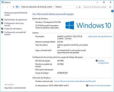

When I try to start Fusion360 ( I work with Fusion since years ago) an error message appears" Fusion will not start because your OS is old ( more or less)"  I´ve tried update and I´ve tried to execute Fusion360 installer ( downloaded from Autodesk website) and in both cases the result is the same : " ..You must update your OS to meet minimal requeriments..."
I have : Windows 10 enterprise 2016 LTSB, Intel i3-3220 processor, RAM 6Gb, SSD free space 20Gb, Direct X12, and, up to now, I worked with this computer  with Fusion 360. I have seen the log file  and I can´t see anything about this matter

Have you tried updating Windows? The minimum requirements for Fusion are here,  oldest version of win 10 is 1809.

Sorry , I didn´t find my Windows version, and now I´ve seen that is 1607. Then , i´ll update my OS.
