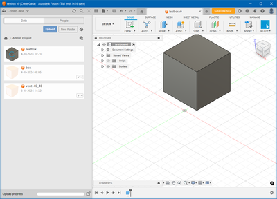

This my also be interesting. This is task manager after I restarted my pc, opened Fusion and drew that box as previous message.

So once more I removed all autodesk related software. I removed appdata and even went in registry and removed everything found on Fusion360.
I completely shutdown my computer, restarted again.
Downloaded a fresh install file fusion 360 and installed it. No icons shown,
Then I created a simple box, once again.  Saved it.
Notice the blue wheel spinning....
Trying to export as DWG. works.
Exporting as STL ... hangs and not responding,
Taskmanager
