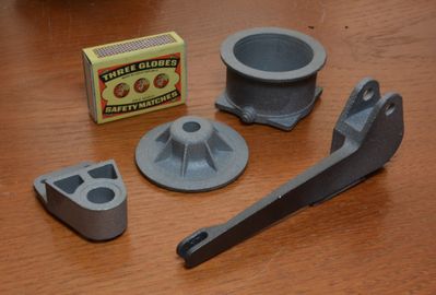

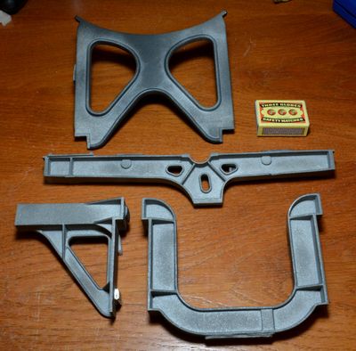

I started with Fusion in July 2017, when I realized, that I can use 3D-printing for my project - a live-steam locomotive model 1:8.  Before that moment I just draw some 2D metal sheet parts in Librecad, this was my first CAD experience. Since that time I created designs for wheels (including molds for wax patterns for steel castings) and some other test parts (directly 3D-printed patterns). During that time I learned quite much, what I can do in Fusion and what Fusion doesn´t like, and also, how to optimize my designs = minimize the work I have to do. And of course, I use the BORN technique. I have been working as a software designer & programmer for more than 30 years, so I´m quite familiar with computers, and my logical thinking is not the worst 😉
Now, having succeeded with test castings, the moment has come to design the whole engine. Regarding my skills and experience I have with Fusion so far (a bit too high probability of weird reactions, sorry), I don´t want to push dozens of parts, each representing dozens of timeline steps, in one single design file. If a one-part-design crashes (like  those beeing discussed now), I am willing to recreate this particular design from scratch again, BUT NOT A MACHINE DESIGN REPRESENTING MANY MONTHS OF WORK!!!
